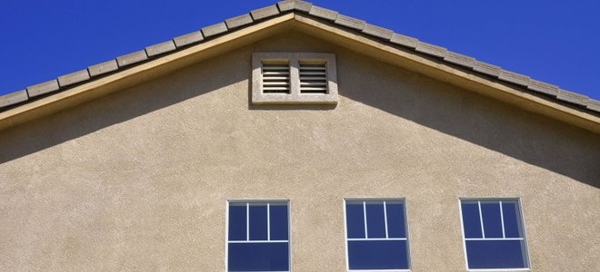

Gable Roof Dormer
A gable is a triangle formed by the 2 sloping planes of the roof of a building, meeting at the ridge beam in the middle. Gable roof dormers project at a right angle to the roof. In a gabled dormer, the side walls take the load of roof rafters and shift the load on to the rafters in the main roof.
Advantages and Disadvantages of Gable Dormers
Gable dormers have a universal appeal. These are traditional in style, simple in design, easy and inexpensive to construct. The gable design uses the force of gravity for the stability of its elements. They provide extra space for living, by allowing 1/2 story space at the top of your house.
Because of their steep sloping sides, the gable dormers allow easier flow of water down the roof. They can withstand most climates and particularly heavy snowfalls. As the snow slides off easily on the steep slope of the roof, there is no danger to the roof for damage on caving in.
These roofs are suitable for places where there is a ban for storied houses, like in some communities.
A gable roof will also not shade the walls at its gables.
