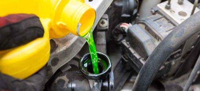

Engine Coolant Level and Strength
Your engine coolant level and strength is another important checkpoint on your vehicle and should be tested periodically. Some manuals recommend taking a look after 60,000 miles (∼96,500km) and then every 30,000 miles (∼48,000km) thereafter. Add some coolant if the liquid doesn't reach the "full" line on the reservoir.
Coolants come in many colors, the important thing to check visually is that it's relatively clear. If it's very foggy/milky, or if there are visible floating particles, you should flush your system and change the fluid.
If the level is good and the fluid is clear, your last step is to pull a little bit out with a baster, put it in a small container and apply a litmus test. If it comes back highly acidic, you should still flush the system, since that can result in corrosion and other damage to the cooling system.
