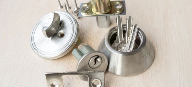

disassembled deadbolt lock
Most deadbolt locks work the same, although the look and style of a bolt lock can vary. Deadbolt locks typically last a long time and a little maintenance will prevent having to replace the lock prematurely. Fixing the lock yourself will be cheaper than buying a new one or having a professional come to your house to repair the lock. Most deadbolt lock fixes are do-it-yourself projects that can be completed in a few minutes.
