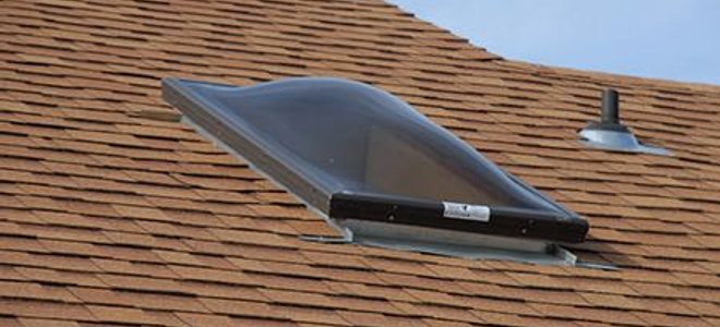

The overwhelming majority of homeowners believe that installing a skylight is a more daunting task than it actually is. In most cases, the manufacturer includes flashing with the skylight packaging. Your local home improvement center sells skylights in 2 categories, which are curb mounted and framed. Curb-mounted skylights are usually manufactured with a dome top which is fabricated from either acrylic or glass.
Manufacturer's of curb mounted skylights who choose to include flashing with the packaging are also oft to design that flashing to fit under the shingles.
When it comes to the home improvement store's selection of framed-in skylights, you will find that rather than having flashing at the head, which is the flashing design associated with curb mounted skylights, framed in place is flashed by a set of shingles.
