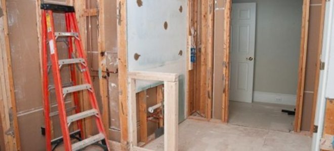

Framing a Door
Door frames are an easy project for those who are equipped with the proper knowledge. First you must plan the location of each entrance, then you must follow a few basic steps to build the doors.
Use the lumber to construct the shoe, the studs and the plate. Leave an extra inch of space above to allow the door to open and close freely. To finish the door frame, cut the lumber to fit the width of the door frame. After that, you will build the crippler studs to fit the distance from the header plate to the ceiling plate. Alternatively, you can cut the lumber to fit the entire space of the opening and space the pieces before nailing them all together.
Once you have constructed the door jamb, put it in place. Many door jambs come pre-fabricated, in which case you will follow the manufacturer's instructions to complete its installment. You may need to use filler strips. Complete the look by adding the top layers such as drywall, paneling, and finish framing.
