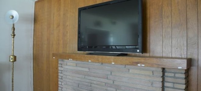

Wall panels are an easy way to improve and add variety to the look of an interior space. They come in many styles and thicknesses that you can choose from. Regardless of these variations, installation is a DIY project easily accomplished with the right steps. This article will explain how to go about adding paneling to your home.
