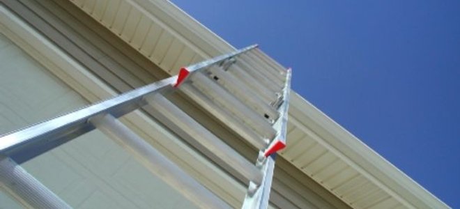

Ladder against the side of a house going up towards blue sky.
