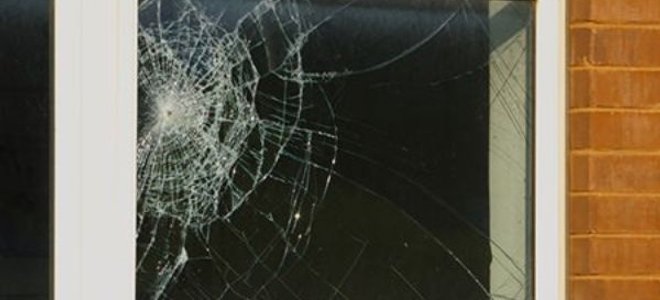

Knowing how to properly remove and replace a broken window will save not only time, but also money, effort, and even injury. Removing and replacing windowpanes is not difficult; however, you must have the proper knowledge and skill to complete the job correctly. There is more to it than simply inserting a new windowpane and smearing putty. This article will teach you how to prepare glass, install glass, add the finishing touches, and replace the glass on doors.
Step 1 – Removing Broken Glass
To simply remove a cracked pane of glass, remove the putty in order to remove the broken glass. The next step is to remove the old putty from the window frame with wither a wood chisel, putty knife, or jackknife. Remove every trace of the putty.
Even if the windowpane isn’t a large one, use protective gloves when you remove the frame. After it is removed, place it on a flat surface. Then remove the broken glass. Gloves will protect your hands against cuts. Though monotonous, the simplest way to clear the pieces of a shattered windowpane is by plucking each single broken piece out one at a time.
