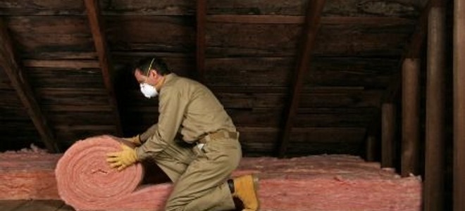

Installing Blanket Insulation
installing blanket insulation
Always apply blanket-type insulation with the vapor barrier facing the interior of your home; the vapor barrier should always be toward the source of heat in the winter. Never place a vapor barrier between two layers of insulation. This can lead to condensation problems and reduce the effectiveness of the insulation.
Lay the blanket as close to the joists and floor as possible. Then, fill any gaps with loose-fill insulation or place another layer of blanket insulation across the previous layer.
Pipes and Ducts
Place insulation on the outside of pipes or ducts. This means the insulation should be between the outside wall and the pipes.
Attic Joists
Staple blanket insulation when laid between joists in the attic. Most rolls of blanket insulation materials have flanges that can be stapled or tacked to the ceiling joists. Always keep the blanket as close to the joists and floor area as possible. Fill any gaps with strips of insulation or loose-fill insulation.
Proper ventilation in the attic is important in any insulation job. Make provision for air to flow in and around the eave vents and to flow out through a ridge vent roof ventilator or through a ventilator on the end of the house. Never allow blanket-type insulation to cut off the flow of air and stop proper ventilation in an attic.
Ceiling Joists
Blanket insulation without a vapor barrier can be wedged between existing ceiling joists. Make sure the insulation comes to the top of the plate to avoid heat loss from the penetration of wind under the insulation. Failure to pay close attention to this detail can lead to a frost line forming on cold, windy days.
