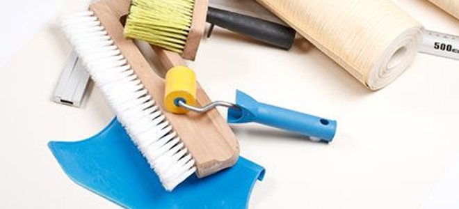

Wallpapering tools
  • 15-30 hours
  • 500-5,000
Razor Knife
Ladders
Spackling Compound
Seam Roller
Screwdriver
Straight edge
Sandpaper
Marking Pencil
Patching Plaster
Work Surface
Smoothing Brush
Wallpaper Paste
Wallpaper
Folding Rule
Plastic Pail
Sponge
Paper Shears
Paste Brush
Paint Edger or Broad Knife
