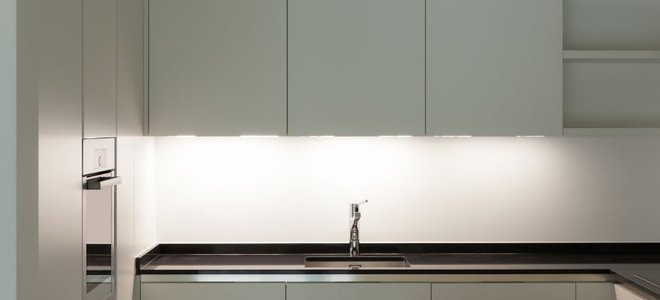

There are two choices when considering under-cabinet lighting — it can either be a plug-in system, which plugs into an outlet, or it can be a hard-wired system, which is hard-wired to work without an outlet. Although the hard-wired system is a more involved installation, the luminous, cord-free lighting it produces is often worth the extra work. Check out this article for step-by-step instructions for how to hardwire under-cabinet lights to improve your kitchen lighting.

Step 1 — Choose the Lighting
Choosing the lights that will fit your kitchen best is one of the first steps with any under-cabinet installation. You can choose from bright fluorescent lighting or small, circular halogen lights. The fluorescents give off a lot of bright light that comes in handy when preparing food. The halogens are not quite as "white," and they work beautifully as accent lighting when the kitchen is not in use.
