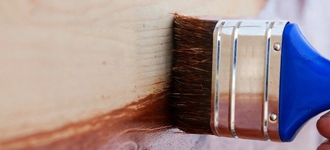

Do it with paint, stain, or a clear sealer of some type.
Paint - Paint encapsulates the wood in a coating that effectively shuts out the elements. It allows you to literally make your wood look however you like, but it does need to be reapplied.
Stain - A simple stain with a built-in sealant is an easy way to protect your wood and get it looking the color you like while maintaining the character of the wood. It takes less maintenance than paint.
Sealer - Clear sealers allow the natural wood to shine through without leaving the wood open to damaging natural elements. A finishing coat of polyurethane or something comparable will keep the wood sealed against penetrating humidity and sneaky moisture that gets into the cracks of your deck, balcony, siding, and outdoor furnishings. Marine-grade varnish sounds heavy-duty, but beware - it's designed to be very strong, but to need a lot of upkeep. Unless you're protecting a boat, go for the poly.
