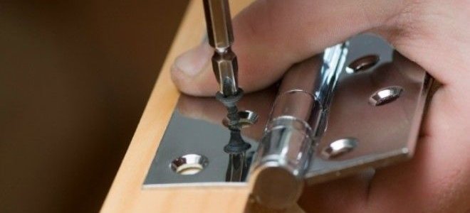

Position one of the hinges on the door in the manner it will be mounted. Line up the top of the hinge with one of your two or three hinge marks. You can now mark the hinge with a pencil, or tap your hammer lightly around the edges of the hinge. The impression of the hinge you leave in the door will be perfect for routing. Repeat this process for each hinge. To save time later, run a hinge screw into each location where they will go later.
Step 5 - Router the Door
Set the routing bit to cut a depth of 1/8 inch. Place the router on the edge of the door and carefully route out each of the hinge depressions you made. If you have trouble getting the right curve or turn for corners, don't worry. You can easily touch these up with a utility knife. Once the holes are routed, test fit a hinge. Use a utility knife, wood chisel, or further routing to adjust the fit.
