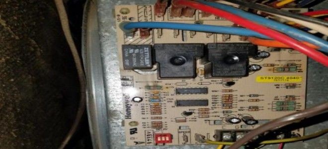

Hey everyone, My AC unit has been acting really weird lately and it started about three months ago. It works and then stops working. I have done different things which will cause it to start working again so bear with me on the long post :-).
When I have the thermostat set to cool, the outside fan and compressor will not come on, but the blower on the furnace will so it will be blowing hot air. We had a technician come out to look at it, but of course the unit was working when he came out. He checked both the furnace and the outside unit and said there was no shorts and everything looked okay with proper voltage going everywhere and nothing clogging the drains.
Of course it went out and assuming that maybe it is just over heated, I would shut the system down from the switch at the furnace and start it up at around 8pm and it would work throughout the night. The next day, it would shut down again. I decided to change the thermostat, capacitor and the contactor outside, even though the voltage was showing correctly when tested. This did not help.
I called the technician out again and now it was not working. He saw the yellow wire that was connected to the AC circuit board on the furnace was not completely under the screw. He adjusted it and the outside unit started back up and worked fine for a month. The outside unit recently started acting up again so I would go upstairs and unscrew the yellow wire and re screw it in and the AC unit works fine.
I am tired of having to do this every time the outside unit will not come on, and I always check to make sure the wires are completely under the screw each time. Does this sound like the AC circuit board might be bad?

Hi, when it happens again, try removing the yellow wire from Y1 at the Tstat and see if you get the same results, post a pic of the control board.
Pdr983 - Thread Starter
I do not know exactly what brand it is but I will find out when I get home. No, there is not a circuit board at the condenser. I will try removing that Y1 at the Tstat tonight to see if I get the same result. Here is the pic of the control board in the attic.

Okay, so the AC stopped working again this afternoon so my wife went up and shut off the power to the blower. When I came home, I disconnected the Y on the Tstat and put it back in. I then flipped the power back on to the blower and the AC fan and condensor came on so I think it worked this way as the same wad unhooking the y on the furnace circuit breaker.

You may want to use a meter to check to see if you have 24V at the yellow wire on the board when this problem occurs, if not, check the yellow wire at the T-stat, If you do have 24V at the T-stat, then board or wire issue, if not , T-stat issue. If you do have 24V at the yellow wire on the board, then check the contactor terminal and find out why the contactor is not working. Hope this will get to the bottom of the problem.

Right after hitting reply, my AC went out. I checked the voltage at the Tstat with the red and yellow and it read 26 but when I went to the circuit board at the furnance, the red and yellow did not read anything. The red and c read 26v as well as the red and fan wire.

0V between R and Y means your unit was calling for cooling.
24V between R and Y means your unit was NOT calling for cooling.
0V between C and Y means your unit was calling for cooling.
R and Y are the same circuit when cooling is running.

Thanks, but the weird thing is, the yellow wire is screwed tight on the circuit board when it stops running but starts back up when I loosen the screw and retighten it.
roughneck77 - Member
There should be two separate conductors on the Y terminal. One coming from the thermostat. The other running to the condenser.
The board in the furnace as a whole has no bearing on turning the condenser on and off, besides providing 24V to the R terminal. The thermostat handles on and off functions of the condenser.

Yes, there is a wire also going from the y terminal to the condensor. I am going to try to crimp the two wires since they might be vibrating and loosen the connection to the y terminal, maybe this will fix it.
One wire on each side of the screw head. Tighten down till neither wire can be pulled out by hand.

@roughneck77 that sounds better so I am trying that. I was over thinking this. I do not think there is a lot if vibration because I watched it turn off, turn on and run. Maybe since the two wires were twisted together to connect to the y terminal, the screw could not evenly clamp down?
Geochurchi - Member
Hi, that terminal on the control board is probably just a junction point, I would try taking the two conductors off and just wire nutting them together.
