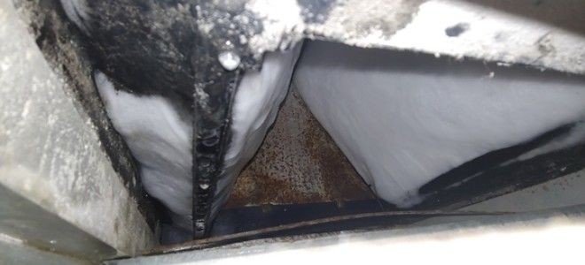

Hello. My "Trane" AC was not cooling since yesterday. I noticed that there is water dripping from the indoor AC unit onto the floor, I checked the filter and it is soaked in water. There is lots of ice build-up in where the filter goes. I attached a picture.
What is the cause and solution?
Thank you!

It’s either a refrigerant or air related problem. Is the blower running?
Bob14525 - Member
As roughneck stated, an iced up evaporator coil is usually caused by either insufficient airflow across the coil due to a dirty filter or bad blower motor, or by insufficient refrigerant in the system.
After the ice has melted, try turning on the fan (blower). If the airflow feels "normal", then you are likely low on refrigerant and you should call in a technician to diagnose the problem (system is leaking and the leak needs to be repaired).

I would say the charge needs to be checked.

I took out all the unit covers to clean the evaporator coils but it looks very clean from the upper side.
The only thing that is pretty dirty is the yellow sponge/foam that is next to the coils.

That’s the insulation for the drain pan for horizontal installs.
It will list the refrigerant on the indoor and outdoor unit.

I had a service call and they said that there is no refrigerant, they said that they can fill it up for $200 but it is going to leak anyway. They stated that the AC needs replacement because its too old. They asked $4700 for a new AC system.

Have a tech recover what refrigerant you have in a clean tank down to 10 psi. Then pump it up with nitrogen to 150 psi and leak search this unit with an electronic leak detector. Repair the leak. Pressurize the system overnite with 150psi nitrogen to leak check it.
If ok, pull a deep vacuum and weigh in the charge using the recovered gas and then finish the balance of missing gas, with fresh gas (refrigerant). If the leak is too hard to find, have the tech inject dye into the system, with its charge, and give it a few days to leak out and show him all the leaking areas. Clear the condensate drain from the pan, down to its outlet.
When the fan switch is in auto, the fan shuts off when the demand is met. If that switch is in the on position, the fan runs continuously. This has a tendency to balance warmer and cooler rooms to an average temperature. It also melts any frost (not ice) accumulation on the evaporator coil, during the off cycle. Make sure all your returns and outlets are open also.
