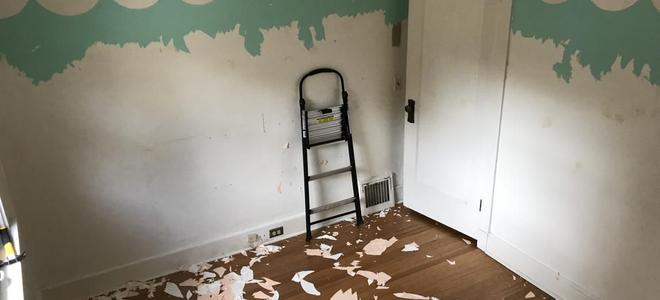

We recently bought an older home and as we were trying to patch the holes on a wall we realized that the paint was peeling. It peeled so easily the we could stick our arm in elbows deep and peel that paint. We then ran into an issue where it only peels every other "area" and we think the prior owner had some crazy pattern or something. The other areas are really hard to peel. We'd really rather not use chemicals and the walls are also plaster so I don't know if that will mess them up. I attached a picture as it's really hard to explain what they had going on. You can see that the owners tried to cover everything in white and the white paint only stuck on certain areas. The areas it did stick on well are where there was a red color underneath, but the red still shows a little. (This pattern goes to the ceiling and we think they wanted it to look like a circus tent.)
What is the best way to fix the holes and prep this room for some fresh paint?

That is a strange pattern; could it be wallpaper still on the wall?
The peeling paint is likely latex, but the original paint was probably lead-based. Lead-based paint is always oil-based, although not all oil-based was lead paint. These instructions will let you determine if it's oil-based. Sending a sample to a lab is the only way to know if it's lead-based:
https://www.doityourself.com/forum/painting-staining-all-interior-exterior-surfaces/230633-my-paint-latex-oil.html
Skimming the affected areas with joint compound will level the wall out, but we need to know what you are dealing with first.

Once you did that, did you jump straight to the paint or did you use primer first? I don't think my case is wallpaper. I think the paint only stuck in certain areas, so I don't know what to do with the paint that is really stuck on. Do I just paint over that?
