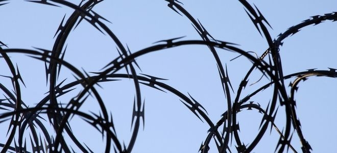

We live on a peripheral lot of our community. When we purchased our house there was (and still is) a section of razor wire maybe eight to 10 ft high, at the very point of our lot. It reaches up to the top of a chain linked fence. Recently, a new chain fence with a run of razor wire was installed on the (vacant) adjacent lot which really makes our razor wire unneeded. I was entertaining the idea of removing it. My research says it is very hard to cut. Any suggestions appreciated.
PJmax - Group Moderator
Any small bolt cutters can cut it but the real problem is in the handling of it as it is so sharp.

I’ve handled concertina wire with chain mail anticut gloves I bought from a restaurant supply store and which most of the time I use to make sure I don’t cut my finger off with a mandolin.
That will protect your hands and if you’re careful that should be enough but watch out for your arms because that can cut through clothes like nothing. Eye protection probably wouldn’t be remiss either.
Esand1 - Member
a protective metal glove
Something like this, and I was able to cut it with relatively small bolt cutters.

Removing the wire (which is all I want to do) has to be a lot easier than installing it. I am almost tempted to simply put on my heavy duty canvas garden gloves and one at a time snip each loop of wire. I'd probably have to cut in into pieces to throw it in the trash anyway.
Hal_S - Member
CAUTION - never, NEVER cut razor wire UNTIL YOU SECURE IT.
Imagine standing on a ladder and cutting a stretched slinky—you are cutting a spring that is under tension and can snap back with VERY nasty consequences.
Actually, you are cutting a razor-sharp spring that is designed to dig into flesh.
A spring that has been stretched and twisted/coiled and can jump out and hurt you.
Throw a few towels over the razor wire to keep it from snapping back when you cut it, or use zip-ties every few feet to keep the coiled wire from snapping back.
