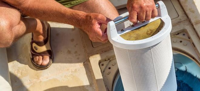

looking down into a pool filter

Maintenance of the Pool Filter System
Regardless of which type of pool filter system is in place, it must be cleaned periodically in order to operate efficiently and effectively.
With the filter cartridge system you must clean the primary and secondary baskets on the skimmer. You must then remove the cartridges and using a garden hose, spray them off until all dirt and debris have been removed from them. If you cannot remove all of it, then you may have to replace the cartridge.
With the sand filter system, you must also clean the primary and secondary baskets in the skimmer. Then you must perform a backwash process that will remove the dirt filled diatomaceous earth. New diatomaceous earth is then introduced into the system by putting it directly into the skimmer. It will then go to the filter in order to do its work.
This maintenance should be performed on a monthly basis. If the pool gets a lot of use however, you should perform this maintenance more often. Taking good care of your pool filter system will enable the pump to service your pool for many years without failure. Make sure to follow all recommendations as outlined by the pump manufacturer for any special procedures that must be followed during this routine maintenance.
