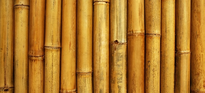

Bamboo fencing is probably one of the oldest and most cost-effective means to erect a boundary for a private area. In order to retain the privacy of your back or front yard, pool, or other structures you can now install a bamboo fence that blends with your construction style. Besides presenting a nature-friendly look, it also adds to the aesthetics of the property. Since bamboo fences are widely used, they are available in different sizes and styles.
Step 1 - Choose a Tall Fence
There is a wide range of bamboo fence styles. The preassembled range is in the form of bamboo rolls or panels with a maximum height of 8 feet. For added privacy and security this is the best choice. Also make sure that the poles in this fence style are close knit.
Step 2 - Erect Wood Posts
You need to erect support poles to install the panels. For this, dig 1 foot deep holes in the ground with a spade at a distance which is the same as the panel width. Make sure that these bamboo posts are taller than your panels so that the panels when fixed to the posts are at least 4 to 6 inches above the ground. For firm support, insert the poles in these holes and refill the sides with soil dug out from the holes. Use a string and measuring tape to check the evenness of the posts.
Step 3 - Fix the Bamboo Panels to the Posts
Each bamboo panel has small wood extensions fitted on each side at regular intervals. These wood extensions are hammered on to the posts with a hammer. Start from the top to retain the desired clearance from the soil. A helping hand will be required to hold the panel while you hammer the nails. Use an A-ladder to secure the panel at the top. Repeat till all panels are fixed. At the end you will have the private enclosure for which you installed the fence.
