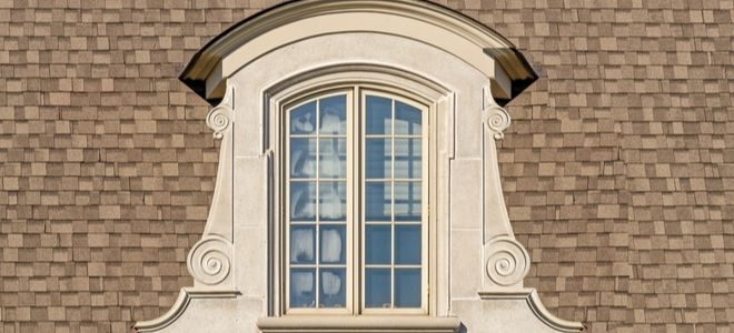

A casement window is a lovely feature to add to your home. If you already have casement windows, you will be aware of the many benefits of them. You will also be aware that if they refuse to shut, they can cause serious issues. If you own a casement window that will not close, here is how you can fix it.
