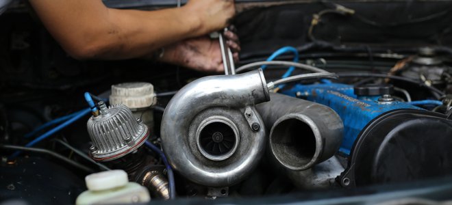

A man works on a turbo diesel engine.

Step 1 - Warm-up
Start the engine and let it warm to a normal operating temperature. Shut the engine off when it is fully warm. Never attempt the following procedures with your engine running, as this could lead to serious engine trouble and costly damage on the injection pump gear train.
Step 2 - Install the Luminosity Probe
Diesel engines rely on a timing meter that employs luminosity and magnetic probes to properly detect ignition patterns. A proper diesel timing meter is an essential tool to accurately read ignition timing. With a timing meter at hand, carefully remove the appropriate glow plug and install the luminosity probe.
Step 3 - Connect the Meter to Vehicle Battery
Power the meter via the engine battery and install the magnetic probe in the front cover holder. Ensure no cables are dangling and are in the way of the engine fan to prevent accidents when the engine is started.
Step 4 - Check Existing Timing
Start the engine and check the timing on various intervals to establish an accurate baseline for analysis.
Step 5 - Adjust Engine Timing
Rotate the injection pump to increase or decrease engine timing as needed. This is usually accomplished by loosening the bolts and rotating the injection pump in small increments either clockwise or counterclockwise. Re-tighten the bolts after adjustment.
Step 6 - Observe and Assess
Observe idle clatter and smoke before going for a test drive. A lean burn is usually preferred for the perfect balance of less smoke and ideal power delivery. Refer to your vehicle owner's manual for proper timing figure.
