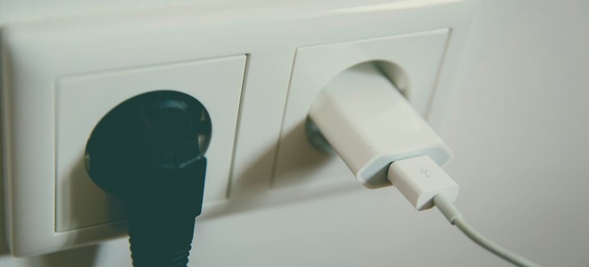

An electrical wall plate is another name for a switch plate or cover plate. It is an item that will cover an electrical outlet or switch, as well as the electrical wiring, and providing an attractive and functional face. Electrical wall plates come in various sizes, shapes, colors, and materials. They need to be large enough to conceal what is behind them and they need to be specific for the job. For instance, in covering a two outlet receptacle, they need to have openings to fit the two outlets snugly, not allowing space in between. They also need to have a portion that extends over the wall. This varies per installation, but there are standard sizes which should accommodate any installation. They are all usually geared to be larger than a junction box or electrical switch mechanism.  The plate is held in place by a single or a series of screws. Sometimes these plates will shift of break.  Below are simple instructions for how to adjust your electrical wall plates.
