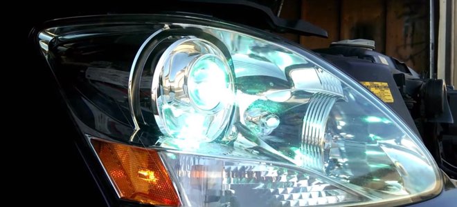

Automobile headlights need to cover 2 aspects of lighting for optimum functionality. The first being brightness and the second direction. The only way headlights can increase visibility is when these 2 aspects are set correctly. If you feel that your headlights are not providing the required amount of visibility, read the content below to adjust them properly.
