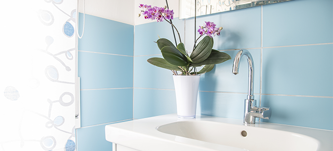

a small sink in a blue tiled bathroom with purple flowers
