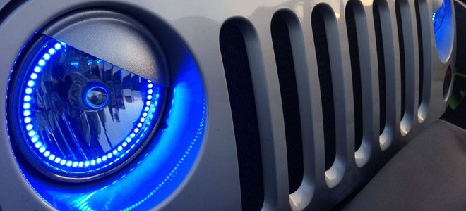

It’s important to properly aim sealed beam headlights. As with all headlights, having them aimed correctly means safer driving. The road ahead will be properly illuminated and the sealed beam headlights won’t be shining in the eyes of an oncoming driver. It’s a simple procedure. Every time you replace sealed beam headlights, you should check the aim on them.
