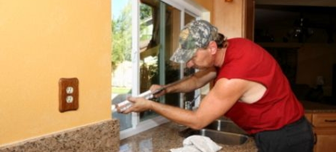

Step 3 - Apply
You need to squeeze out a smooth, even bead of silicone rubber sealant along the window. This can be the trickiest part of the process, and it’s worthwhile taking time to practice in order to master it. You don’t need to squeeze hard; just keep up a low, even pressure and run the tube along between the pieces of masking tape.
Don’t try and run sealant around the entire window in one go. It’s much better to do one side at a time, as this means you’ll be able to work without risking the silicone drying out, and you won’t feel under any pressure to rush.
