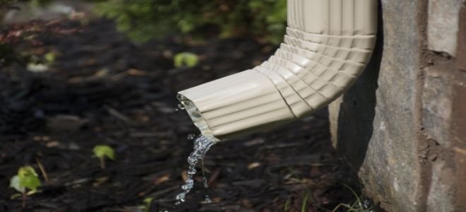

In various areas around the world, homes need downspouts to collect and carry the water from the half-round gutters down to the drain. If this is not done, the rainwater could cause possible damage to the structure of the house by eroding the soil that is present along the foundation and causing leakage down to the basement. In order to attach the downspout to half-round gutters, follow the steps described below.

Attach the outlets of downspouts to the holes that were drilled earlier. Secure the outlet with pop rivets. Once the outlet tube has been securely attached, fix a downspout elbow to it. Ensure that they are screwed together properly. Attach a downspout that has been cut according to the measurements between two elbow downspouts.
One of the elbow downspouts has already been fixed with the outlet tube. Crimp the elbows slightly with the help of needle nose pliers so they may fit perfectly with the downspout. Once that is done put the parts together using screws or pop rivets. Usually, two downspouts are required in a single-story building and three downspouts are required for a double-story building. Once everything has been fixed, run water through the half-round gutters, which in turn will pass through the downspout, to ensure that the water is not dripping from anywhere.
