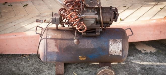

Air Compressor Sizing
For the most part, you’ll need an air compressor that provides the appropriate CFM (cubic feet per minute) for the equipment you’re using. Consult the owner’s manual for the recommended rating for CFM and psi (pounds per square inch) or speak with a representative at your local home improvement center about adjusting/regulating the air pressure. Usually, 80 psi is used for rigid PVC pipes and 50 psi is the standard for black polyethylene pipes.
As a general rule, using a pressure regulating valve prevents excessive air pressure, which can cause damage if not kept in sync with the air volume.
If you don’t own an air compressor, the equipment is available at home improvement centers or you can rent the compressor from a local equipment rental shop. Before buying or renting, be sure you choose a machine that has the power to do the job for the size and type of sprinkler system you’re working with.

Step 3 - Prep Compressor
Turn on the compressor and follow the manufacturer’s directions for setting/charging the air compressor's psi. Once the psi is set, turn off the compressor and close the compressor valve.
Step 4 - Connect the Hose
air compressor
Attach the compressor hose to the hose bib at the sprinkler’s mainline. This may require using a connector or adapter since the fitting between the hose bib and the air compressor hose may not align properly and result in a non-secure seal.
