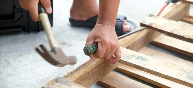

Technique One
The first technique is a physically demanding one: breaking down a pallet using a crowbar and hammer. The advantage is that it keeps the boards intact while removing nails that could later rust and ruin the look of your project. To do this, place your crowbar near the end of each board. Tap it into the place where it meets the center 2x4 and pry it apart.
This can create enough pressure to split your boards, so work slowly. You may need to trim the end off your board if a split is unavoidable. Repeat the process until all boards are separated and removed.
