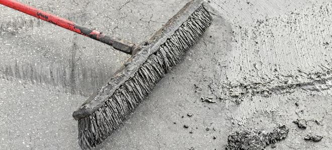

Step 3 - Broom Finish the Concrete Surface
Take a concrete broom and run it across the concrete surface. You have the option of using a regular household broom but it is recommended that you employ a concrete broom that professionals use to broom finish concrete for better results. Hold the bristles of the concrete broom at approximately a 45-degree angle with the cement. Keeping in mind in which direction people usually walk on the surface, pull the broom from one corner of the surface to the other in that direction at a 90-degree angle. Now shift the broom to the edging of the surface where you have applied the broom finish.
Step 4 - Consistency and Edges
Keep the pressure exerted on the cement uniform at all times to ensure that a consistent set of marks are produced on the cement. Then move onto the edges of the concrete slab and finish them. This is where an edging trowel comes in handy. Use the edging trowel to round off the edges of the concrete slab and make a flat margin. This helps form a consistent border for the broom part of the concrete slab finish. However, do not undo your work by allowing people to use it immediately. Give the cement adequate time to dry off before allowing people to walk on the concrete slab.
