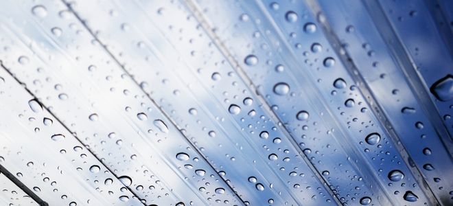

Step 3 - Prepare The Polycarbonate Panels For Installation.
The reason we used the 10 feet panels is that the slanting length of the roof might be longer than the other available panel dimensions. Measure the slanting length of the roof to determine the necessary panels. If the roof length is less than 10 feet, you only have to use one polycarbonate sheet. If the length of the roof is longer than the panel, you will have to cut a piece from a new panel to supplement the full piece.
To minimize work when installing the panels, take all measurements twice, and cut the pieces accordingly using the circular power saw. Also, use the drill to make holes in the steel frame at the points where you intend to screw the panels.
polycarbonate panel
Step 4 - Install The Polycarbonate Panels
The only remaining part is fitting the panels in the right place. Position the panels one by one while you screw them to the steel frame. Make sure to extend at least one foot of polycarbonate panel outside the frame for water drainage. To ensure that the sheets hold well, place the foam strips along the steel frame. These provide a good ground for the screws, and help ensure the panels aren't scratched by the steel frame.
