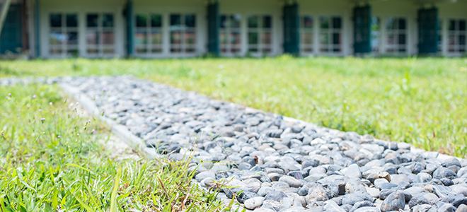

Crushed white pea gravel
Add gravel to the length of the bottom of the trench. Crushed pea gravel works well for this. It should cover the trench to a depth of about one-half inch. Once the gravel is in place, you can add some decorative river rocks. Use rocks in varying sizes to create a natural look. This is the fun part; you can place river rocks according to your own taste to make the dry rock stream look just as you wish. You'll need help to place larger rocks in the dry stream. Don't attempt to lift more than what you can reasonably carry.
