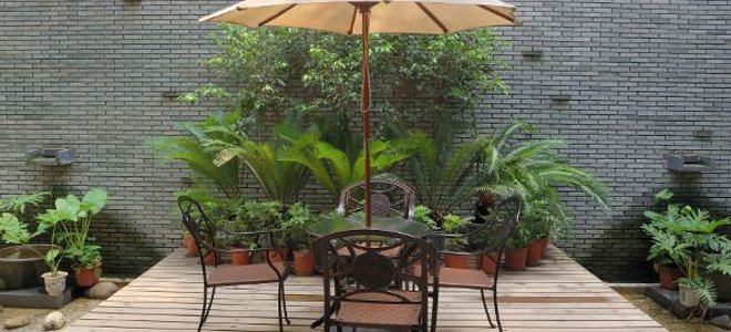

How to Build a Floating Deck
A floating deck with a table and chairs set on it surrounded by plants.
