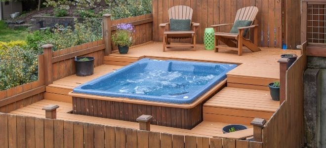

backyard with multi layer deck
Step 2 - Decide on Design and Layout
Adding a level to an existing deck is an easier way to create a multi-level design, especially if you can salvage any of the framework and decking materials that are still in good condition, and in keeping with your planned footprint. If you aren’t so lucky, factor in demolition and rubbish removal into the budget so you can start with a clean slate.
There was a time when redwood and cedar were the only choices when building a new deck. These days, the wide variety of decking materials available allow you more options so you can choose based on factors like your environment, your budget, and your own preferences. Pressure treated wood is a less expensive option from cedar and redwood, but will require regular application of sealer or stain at least every other year to keep it looking good. Vinyl and composite decking require less maintenance, but are at least as expensive as natural redwood.
Once you’ve decided on final design and type of materials, procure your materials and store it appropriately until construction begins.
