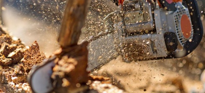

Use a chain saw to cut the ties to length. Offset the ends to keep the rebar lengths from interfering.
