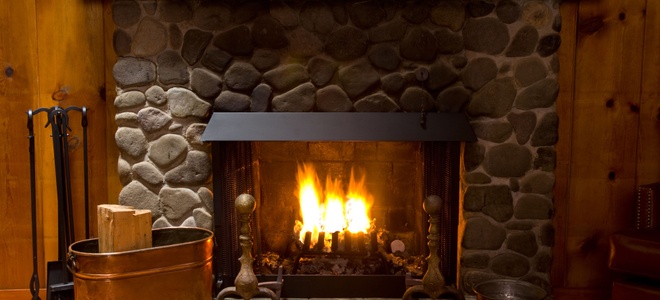

A stone barbecue can be an ideal tool for cooking in your yard or outdoor area. Many families like to participate in outdoor barbecues as long as the weather permits. But these barbecues may cost you a lot of money. You can build a barbecue made of stone yourself, and it will not be as expensive as the purchasable barbecues that you find in stores. Basically, a stone barbecue is made of stones and a grill made from metal.
