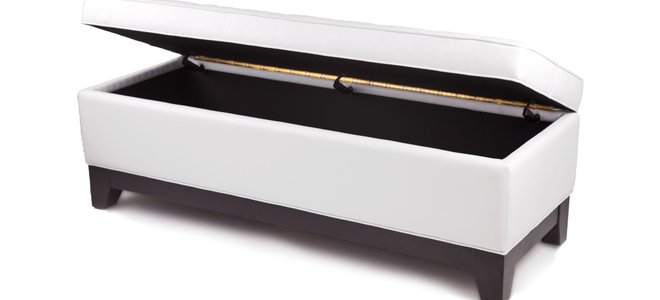

Having extra storage at your fingertips can be a valuable commodity. When you combine that with a handy ottoman, you can enjoy both comfort and storage. The storage ottoman is an asset whether it is used to store books and magazines in the living room, CDs and DVDs near the entertainment center, or in the kid's room for their favorite toys. This easy DIY project can be completed in a short time with some basic tools, a few supplies, and a little know how.
