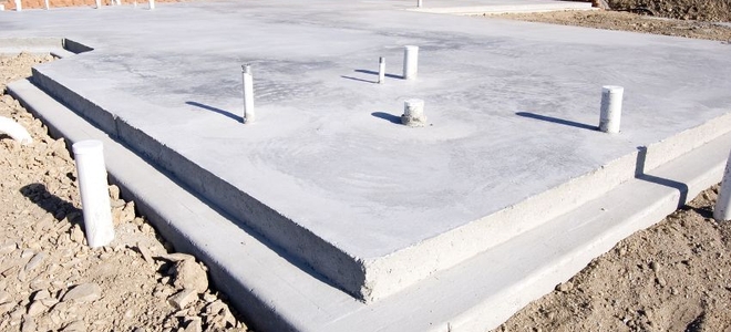

A strong foundation is important for any garage. Without the right footings, you are risking a garage foundation settling and cracking. This can end up causing serious problems with the actual garage. Here’s what you can do to make sure this doesn’t happen with your garage.

Go ahead and put wooden pieces inside the form. Place at least 2 sections of rebar in each form section on the top of the wood pieces. Use wire to tie around the rebar and the wood to help keep the rebar above ground. If done properly, this will suspend the rebar.
Pour Concrete
You can now start to pour the concrete. This will take two people to accomplish. You will want one person to set the anchor bolts in before the concrete sets. For this project, it’s best to avoid using quick-drying cement to give you some extra time. The anchor bolts need to be centered.
Once the concrete has dried you can take the inner form out and use gravel as backfill for the center of the garage. Using ¾ inch gravel is the best for this project. You won’t see the gravel once the garage is in place.
Now you’re ready to start building your new garage on the foundation that you poured yourself.
