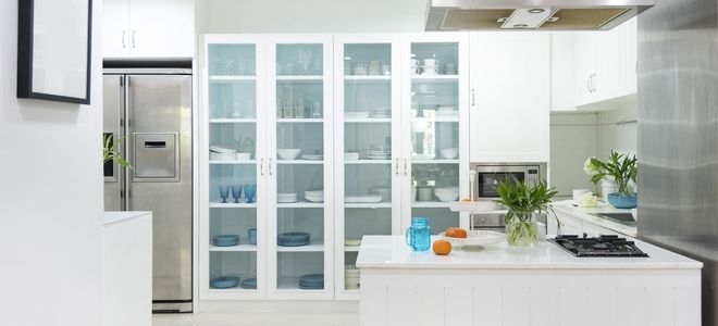

Glass bifold doors are a very functional and attractive type of door that can be used in various places throughout the home. Bifold doors are ideal for dividing rooms, as wardrobe doors or even as external doors in some cases. Glass bifold doors are fantastic for many reasons.
Building your own glass bifold doors isn't very difficult. If you have the right tools and materials required then you should be able to build a glass bifold door over the course of a single weekend.
Planning and Designing
The first thing that you need to do is to plan your bifold door. It's important to realize that the glass bifold doors should be made using a wooden frame with a glass panel insert. Alternatively, several smaller panes of glass can be used depending on the design you are trying to accomplish.
Design your glass bifold doors on a piece of paper and carefully plan the correct size of the doors. Make sure that the doors are all equal-sized and that they will open properly.
