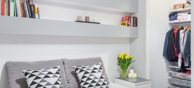

shelves above a bed with books and candles
Wall-mounted shelving is a great way to keep your books neat and tidy. It does not matter how big or small your book collection is. You can keep these books in better condition for years to come with proper shelving. If you are tired of your books stacked everywhere, you can start this project. It does not require much skill to build wall-mounted shelving.
Plan the Design
Decide where you want to place your wall-mounted shelving and how long you want the shelf to be. Be sure the shelf has enough depth to place your books on. You can choose any species of lumber except plywood as it is not strong enough to carry the weight of books. Oak is the preferred choice for shelving.
