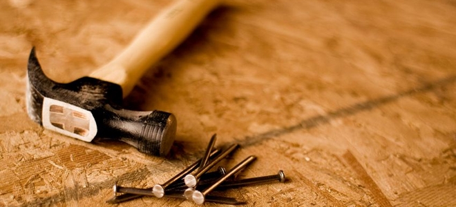

Hammer and Nails on plywood

Step 2 - Assemble Cube
Assemble the four sides into a square. Use glue along the edges to join them together and add nails to strengthen the joint. You can also use screws but it is recommended that you drill a pilot hole first to prevent screws from splitting the wood. Attach the base piece to the cube in a similar fashion. Once the cube is assembled, sand down rough edges and fill any holes or joints with wood putty for a clean finish.
