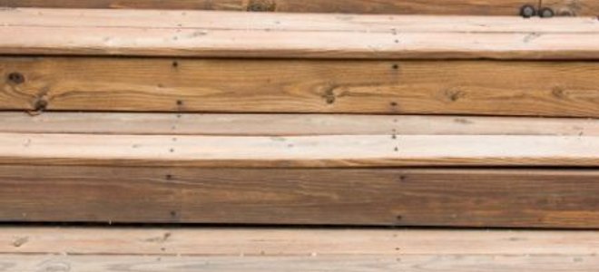

Step 4 - Cut the Treads and Risers
wood stairs with tread on the edge
Based on your measurements, cut the treads and risers from the pressure-treated wood.
Step 5 - Affix the Stringers to the Porch Frame
Drill holes for the L-shaped brackets, and attach them at the farthest left and right end of the stairway, longest side vertical to the porch frame, with three-inch deck screws. Affix the middle stringer to the deck, from the deck outward with two three-inch deck screws, drilled into the back of the stringer.
Step 6 - Attach the Risers
Using three-inch screws, fit the risers onto the stringers vertically. The step treads will sit on top of these supports horizontally.
Step 7 - Add the Step Treads
Screw the step treads down with one screw into the stringer and one into the riser for each stringer support. Walk on the stairs after you're finished to test for firmness.
