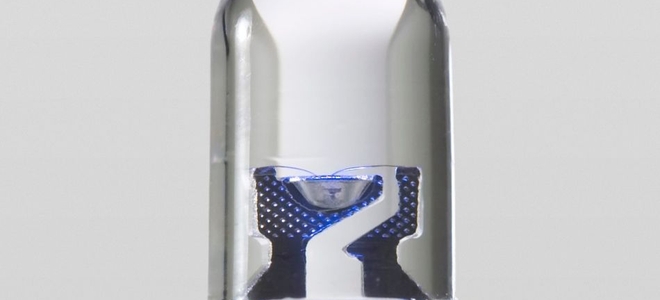

An LED light panel is a lighting source made of a flat sheet with light created by light emitting diodes, AKA, LEDs. The light is spread evenly through the panel’s distribution system.
As a semiconductor, a Light Emitting Diode (LED) converts electricity into light using less energy. LED lights are easy to handle and since they also save energy and last awhile, they are considered a good substitute for conventional fluorescent tubes and incandescent lamps for indoor as well as outdoor lighting; a perfect choice when it comes to cost and practicality.
