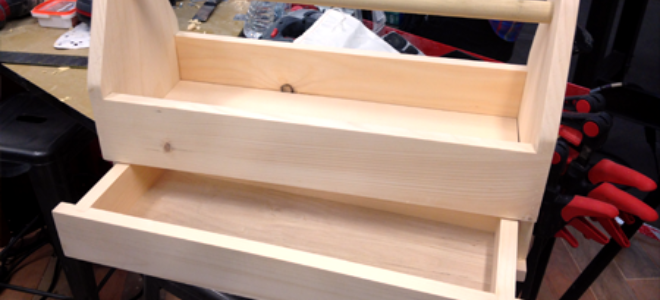

Step 3 - Build the Toolbox
smaller toolbox filled with tools
A basic toolbox consists of two sides, two ends, a bottom, and a handle. Cut these in a size of your choice. Pre-drill holes in the toolbox ends, at the junctures where they will meet with the toolbox sides. Also, drill holes in the toolbox bottom where it will join with the sides and ends.
Spread a bead of glue over the edges of the sides and ends and press them together to form a frame. Wait for the glue to dry and fasten with nails or screws. Spread some glue over the toolbox bottom and press it to the frame. Wait for the glue to dry and fasten. All that remains is to add a handle to your toolbox.
On each side of the toolbox, drill a hole with the same diameter and position. For a handle, you can use a dowel with diameter equal to that of the holes. Run the dowel through the holes and fasten with nails.
Step 4 - Finish Up
Sand the whole toolbox with 120-grit sandpaper to smooth any rough edges. Apply a protective coating of wood finish (e.g. exterior-grade paint) and wait for it to dry. Your brand-new toolbox is now ready to use.
