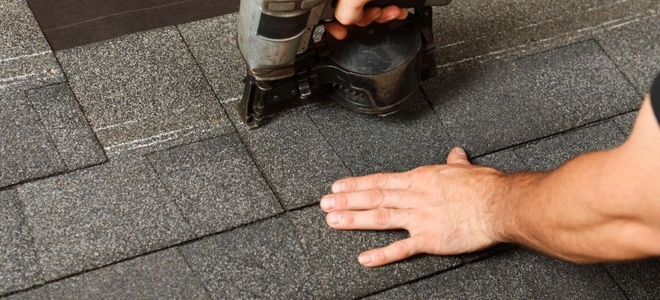

Asphalt shingles.
If you live in an area that is prone to moisture and fungus, you may want to invest in zinc strips. These are placed at the peak of the roof across the top. When it rains, a small amount of zinc is then carried down the roof. This will place a light coating over the roof and prevent any kind of fungus from forming. This is a great investment and can save you lots of money later in replacing shingles that have been damaged by fungus.
Replace Damaged Shingles
Having just one shingle that is damaged from storms or fungus can create a much bigger problem later on. It’s best that you inspect your roof at least once a year and replace any shingles that have been damaged or are popping up. If you find shingles that are popping, you can get away with just gluing these back down. If they are damaged in any other way, it’s best to go ahead and replace them.
