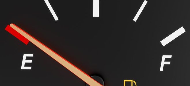

In vehicles, the device is made up of two components: the sensor system and the fuel indicator. The sensor device often runs on the float attached to a potentiometer. When the vehicle tank runs dry, the float falls and turns a shifting connection over the resistor, maximizing its resistance. Furthermore, as soon as resistance reaches a specific level, it is going to also switch on a low gas light on certain cars.
At the same time, the fuel indicator system (often installed on the dash panel) is calculating as well as showing the volume of electric current passing through the transmitting system. As soon as fuel volume is increased and optimum electric current is passing, the gauge reads (F), showing a 100 percent full car tank. If your tank is dry and the minimum electric current is moving, the gauge reads (E), showing a dry tank.
