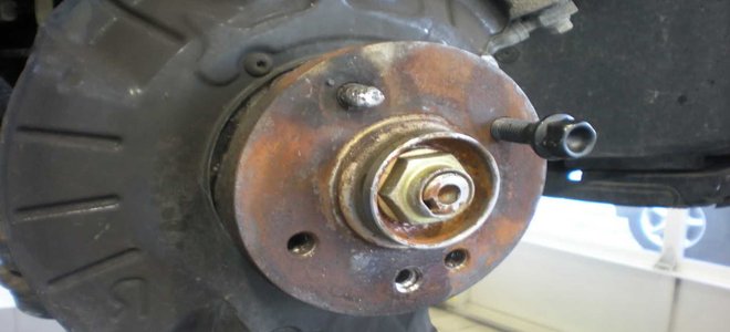

Step-by-Step Procedure for Removing Wheel Bearings
  1. Jack up your vehicle. The first thing that needs to be done to remove a wheel bearing is to jack up your vehicle on a level ground. This is important from the viewpoint of safety.
  2. Disassemble the disc brake or drum brake assembly
  3. Remove the bolts. You will now be able to access the hub, which holds the bearings. Remove the hub lock bolts to get it loose; this will enable you to dislodge and separate it from the wheel drum.
  4. Remove the locknut. Remove the pinion gear from the shaft of the hub. Thereafter, use your hand to hit the hub and, thereby, release the locknut from it.
  5. Remove bearings. Use pullers to remove the bearings from the hub. If the bearings have been damaged considerably, you will have to remove the inner race of the bearings by striking it with a punch.
  6. Clean the hub. Use rags, preferably soaked in some solvent, to thoroughly clean the inner side of the hub.
Replacement of Wheel Bearings
  1. Remove shaft seal. Remove the shaft seal from the hub and drive a new seal into the same position. Place the hub on the ground with the extended shaft facing upward; next, place the new well-greased bearing over it.
  2. Drive in the bearing. Incorporate a sleeve atop the inner race of the bearing and drive the bearing into the hub well. Stop when you hear a metallic noise, which indicates that the bearing has reached its position.
  3. Fix the pinion. Re-attach the locknut and fix the pinion gear in its place. Fix the hub assembly, brake assembly, and the wheels.
  4. Double check if the bolts are tight. Double-check whether the hub, brake, and wheels are tightly bolted to be sure that the assembly does not give way while driving.
