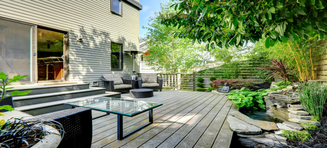

Cleaning a granite paver patio can help to rejuvenate it and keep it looking good. Granite pavers are highly durable, but they can still be affected by weathering and usage. Granite pavers can be professionally cleaned, but this is an expensive job. You should be able to save yourself a few hundred dollars by doing the job yourself. Doing the job yourself does not require any specialist skills. All of the required materials can be obtained at any well-stocked garden center or DIY store.
