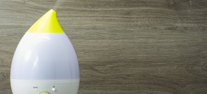

A humidifier is used by many homeowners to help to increase the moisture level in a room or home. Cool and warm mist humidifiers are popular. Humidifiers have to be properly maintained to ensure that they work efficiently. If you use a humidifier daily, you should clean it regularly, at least once in a week.
Review the instructions provided by the manufacturer in the manual before starting your cleaning work to ensure that the materials you use to clean the humidifier suit the machine and avoid any damages. Cleaning the humidifier is easy if you follow these cleaning tips.
