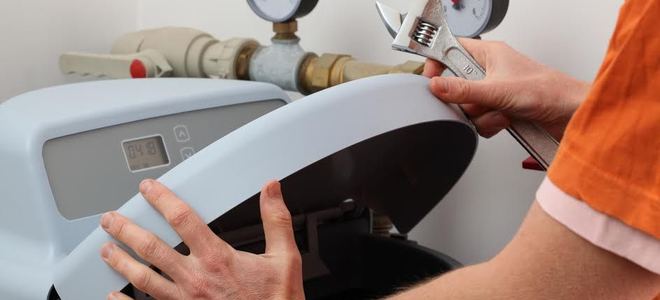

Step 2 - Find Your Brine Tank
water softener
Find and carefully remove the valve assembly from your brine tank, or your salt-water tank and set aside. Remove all the salty water and brine from the tank and throw it out in a place where it will not be able to harm your plants. If nothing else, you can pour it down a street drain.
After the brine has been cleaned out, remove the valve chamber by unscrewing the bolts on both sides of the tank. Clean the salt plate that you will find on the bottom of the tank. Clean the tank with a cleaning brush and then rinse it thoroughly in your shower or with a garden hose outside.
Step 3 - Re-Install
Once everything is cleaned, you will need to assemble it back together, and fill your salt keeper with new salt. When it is assembled, fill the tank with 5-6 inches of water.
After it is completely reinstalled, you will be able to turn your water and electricity back on and test it.
